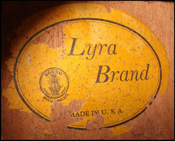

Am looking for info on a c.1898 Bruno Made in USA, Lyra model acoustic "parlor" guitar. It may have been a guitar that could have been purchased from a Sears or Mont. Ward catalog?

C. Bruno & Son was founded in Macon, Georgia
: in 1834 and the company has been in the music
: distribution business up until the present day
: (they are currently a part of Kaman Music
: Corporation). In 1838, Charles Bruno and C.F.
: Martin entered into a partnership to produce and
: distribute acoustic guitars that only lasted one
: year. These acoustic guitars are labeled with both
: names, and were produced in New York. Throughout
: their history, Bruno musical instruments were
: manufactured by other companies and then
: distributed by C. Bruno & Son. In the 1960's,
: Bruno imported their instruments from Japanese
: manufacturers.
I've now found names for other Bruno's guitars such as 'Stella' (from the 50's). Since I now know that they were a distrubutor and didn't produce the Lyra...it will be interesting to find out what company did. Kaman should have the company history...so we'll contact them.

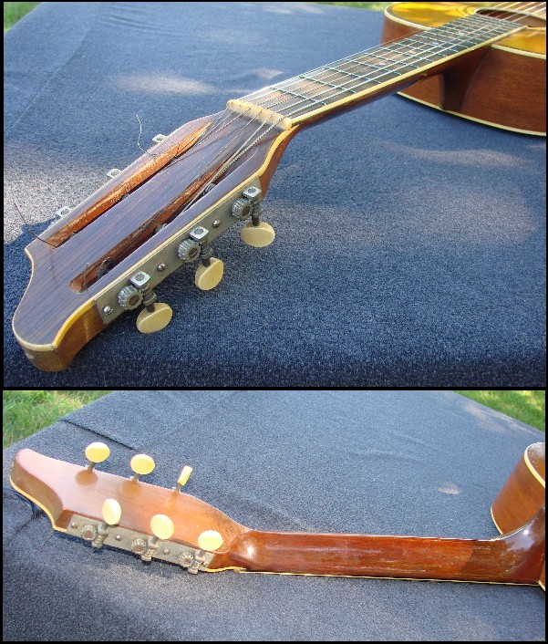

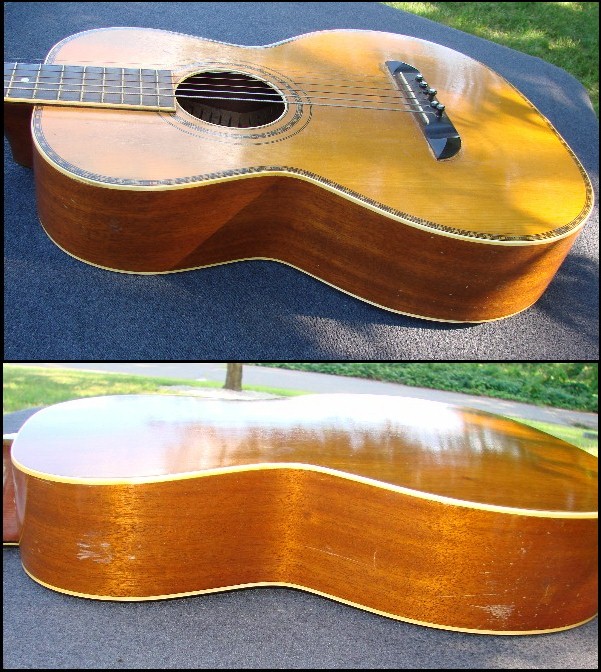

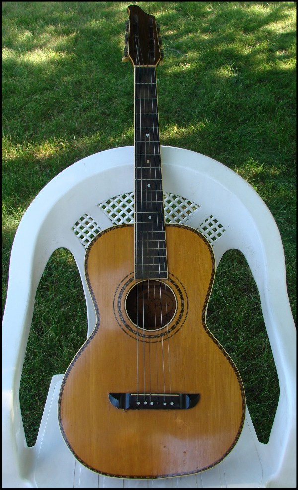

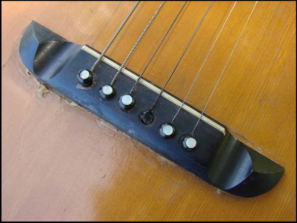

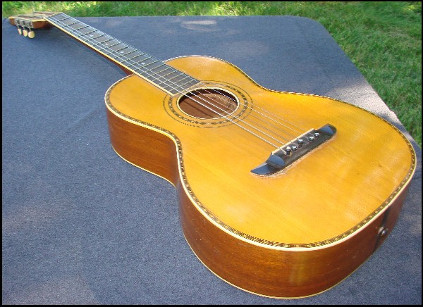

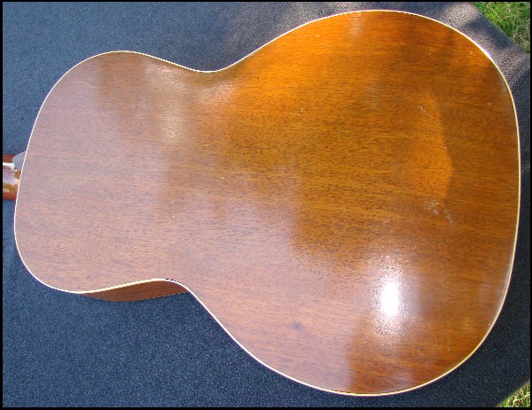

Tried out this guitar and despite some condition issues (and aged strings), it produces a nice mellow sound. The major issue is the bridge, which had been poorly re-glued is lifted/separated...due to the strings never being loosened. However, this occurrence appears to have saved the neck. The neck is straight, but could use a slight adjustment. Don't know if a truss rod was used in these guitars anyway, and I saw a wood block in the interior -where the neck is attached to the body. I'm thinking no truss rod - the weight of the guitar is very light.

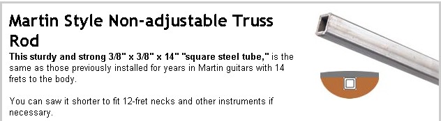

Looks like an instrument worthy of saving. If the neck is not warped and frets properly dressed the 'action' can always be improved upon at the nut & the saddle (bridge).
Most of these acoustic instruments had mahogany necks and various makers, including Martin, used a square tubular non-adjustable truss rod to stiffen up the neck and resist the bowing from string tension. As I don't see any access to a truss rod on the headstock and you say you only see a wood block at the attachment point through the sound hole, I suspect this instrument is not adjustable - as you suspected.
The bridge can be re-glued (hot hide glue strongly recommended) after the wood surfaces are properly cleaned.

Who knows what they used for glue on the bridge repair. My concern would be splintering the top while trying to get the bridge off. Then you pretty much have a stick of firewood.
I think the only way to take the bridge off is to have it done professionally. If the bridge is tight and the top isn't bowed, I'd probably leave it as is, and just try to trim the extra glue off around the bridge.

What kind of wood is it made from? Is it solid wood, or laminated?

Here's some info on Lyra Brand guitars. I'm not sure of this, but I think some models were made by Stella. http://www.solie.org/earlsguitars/lyra1.html

The tuning gears, metal strings, and bridge pins make it much later than the turn of the century I think.
The body is mahogany.

I does look like mahogany. A lot of older guitars were made out of mahogany, before it became a rare wood. I used to have a 3/4 solid mahogany guitar from Sears & Roebuck. The strings were about 1/4 inch above the neck, and it was awfully hard to play. I remember getting blistered fingers on my left hand. I'd like to have it now, though, knowing what I know about setting up guitars. It would have been pretty sweet if I'd have taken the nut and bridge down and made it playable. I think Dad threw it on the rockpile in the woods and lit it on fire, after it sat in the closet for years.
The Lyra definitely isn't rosewood. Rosewood has inky dark streaks throughout the grain.

I read in one of my Martin books that all old parlor guitars were set up with nylon or cat gut strings, because they had no truss rods, and steel strings would either warp the neck or heave up the bridge and body. The steel strings may be the reason the bridge lifted.
Too bad it's such a sloppy glue job. The rest of the guitar is in remarkable shape, considering the year.
